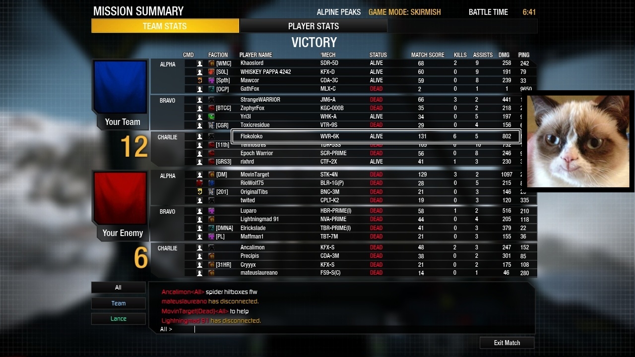

    Much Damage, much heat, but a lot of fun!

  16. Flokoloko
    WubbWubb even makes Grumpy Cat smile... ;)
