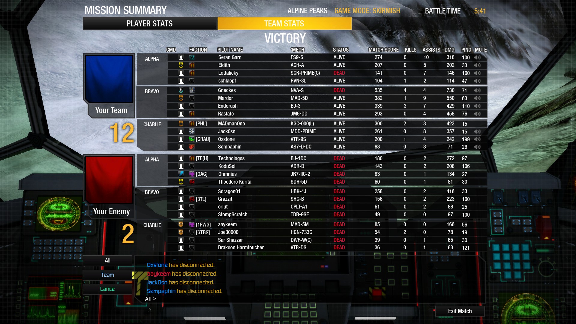

    Just got this, on Alpine Peaks, just brawling on/around the I9 hill:
    Mech was basic'd, but no Elites unlocked yet.
  9. anonymized1
    4 solo kills......sweet!
    Gneckes31 likes this.
  10. Gneckes31
    Thank you! :)
  11. Gneckes31
    And another one:[​IMG]
    The Nova is rapidly becoming one of my favorite mechs.
