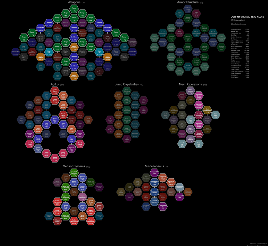

    I'm running this skill tree (this is one of the few mechs where survival is actually a waste), so my Osiris actually runs at 153 km/h instead of 140+. TBH even at 140+ you can outrun most enemies, in fact you could even fit a XL255 and still run at 148 km/h.
    IMHO right now, with piranhas that can easily catch any light, it is better invest in cooling for sustained DPS rather than speed to try outrunning them.
