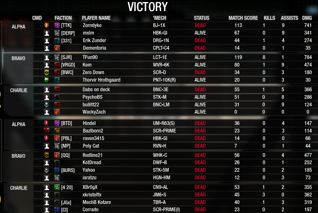

  12. Revostae
    Revostae New Member
    It is a really fun build. The 1200 damage one was clearly a fluke (in case anyone was reading this and expecting that lol), I normally get around 400-700 damage in a game with this build depending on how long it went and if we win.
    I do love the completely "spammable" alpha that does a lot of damage. Get behind a heavy or assault and just keep unloading on them.
    tfun90 is definitely right though, you miss the range sometimes. It really shines in maps with lots of cover (like city maps).

    I meant that if you use MLas instead of SPLas on this mech, your effective range is 365 in stead of 149.
