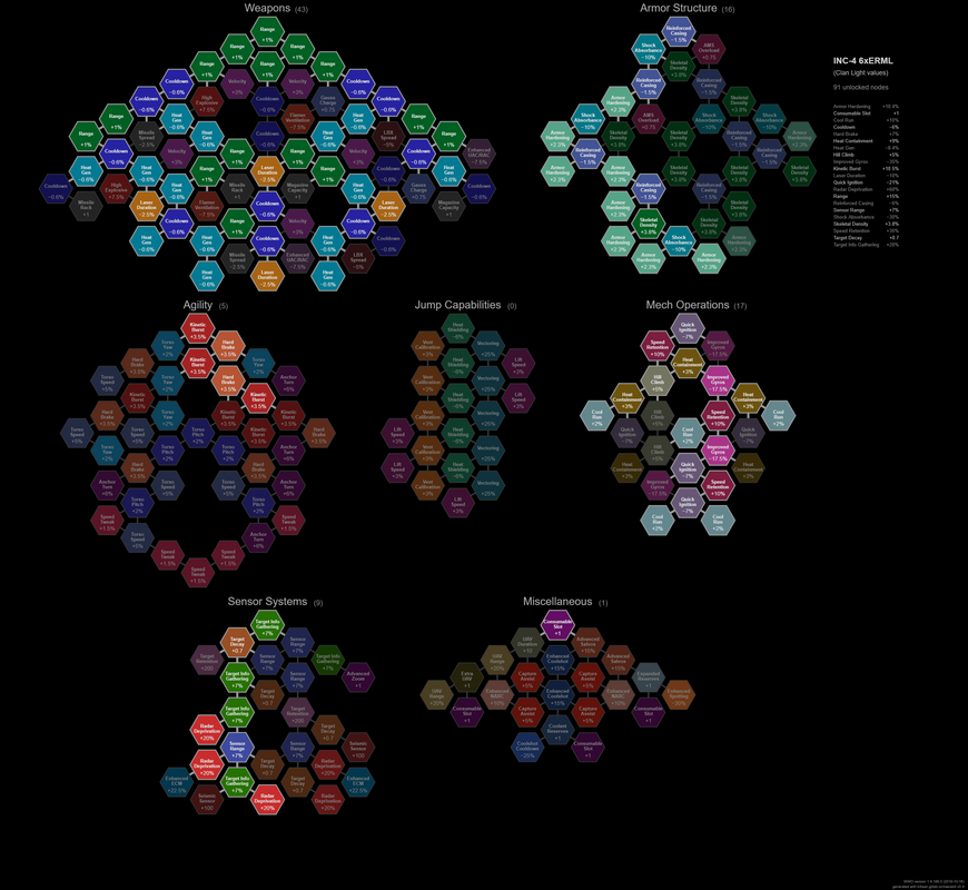

    I'm really amazed nobody thought of this build... Pretty straightforward: very high hardpoints (like a battlemaster), decently fast, good heat dissipation, good range, huge alpha for being a nimble 30 tonner.
    Skills are very similar to any other vomit laser build: max heatgen, max coolrun, max range.
    Max heat gen, max range, max laser duration, max coolrun, skill most armor and radar deprivation, skill a bit of acceleration / deceleration and fits 2 consumables
    Like v1, but sacrifices mobility and the 2nd consumable for a maxed seismic sensor
    Like v1, but trades survivability for mobility and an additional consumable
    ALT (2nd iteration): swap a DHS for a TC1. Optimal range and maximum range will benefit and you will be cool most of the times. If you ever find yourselves in a brawl or in the need to fire early, you are screwed.

    UPDATE: changed main build to XL235 version (more cooling is better due to the support role of this mech, you can't brawl anything and you need all the help you can get if anyone wants to push your position), added recommended skill trees.

    I just got an INC-4 and took it for a spin with a 6xERML build. Confirmed fun! And I think fully skilled up it is going to be a solid midrange fire support poker/harasser.
    I'm doing the XL255 version, without a TC:
    With this skill tree:
    https://kitlaan.gitlab.io/mwoskill/...062301cf37f0000d86fd70f000080af271f#s=Weapons
    (1 strike, 1 arty, 2 coolshots, 1 UAV)
    Post skill up report:
    Confirmed fuuuun! and effective. Might never be a 'meta' mech, but it is solid.
