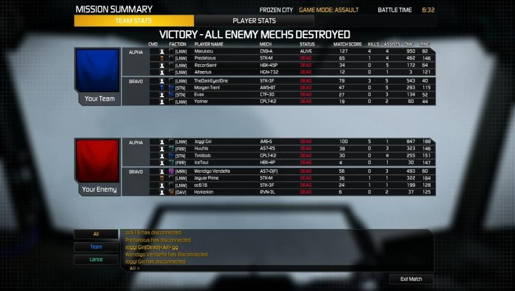

    THIS IS WHY THIS BUILD IS THE BEST!
    I killed the HBK, JM6, a STK and AS7
